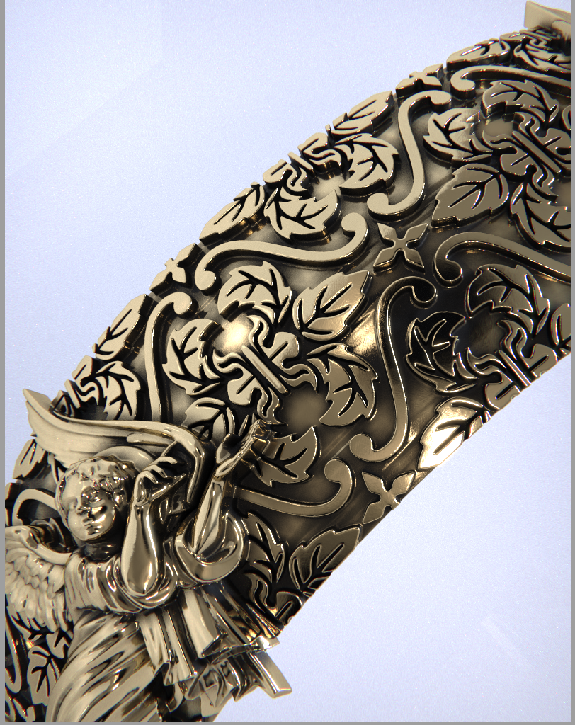

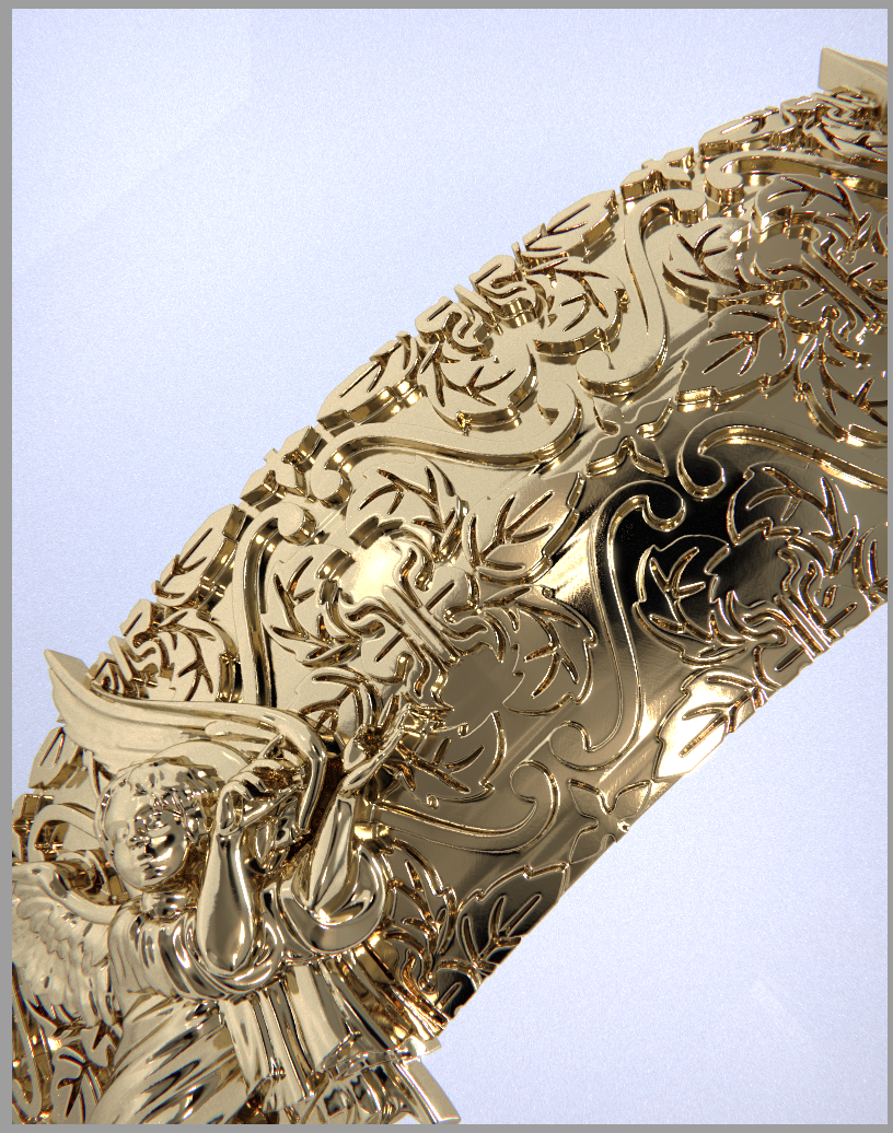

Hello. I’ve been trying to solve the jewelry blackening issue for quite some time. I picked up the material of ordinary gold, which looks great, but when I try to add blackening, the shade of the metal changes and the shine disappears. Help please
I am attaching my version of the material

With blackening
What I did was to use the default gold and since it’s some kind of anodized layer I used an customized anodized layer as the label.
Like your material I based the opacity on the occlusion and added an invert and adjustment to have some tweaking options of the opacity. The actual color/roughness of the anodized material I just tweaked a bit with the settings and you can easily get it darker or less dark using the sliders.
I’m by no means a jewellery expert but maybe this helps you a bit.
